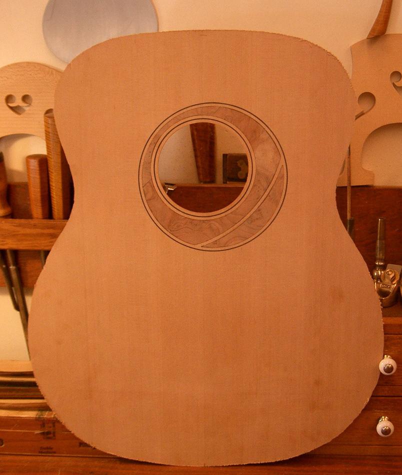

Here's a picture of a rosette one of my customers sent me. His name is Thomas Groppi from Canada. I thought it was pretty nice and wanted to share.

Thank you all so much...(tx Bob too) It really motivates me to build more... I ve acutally spend a few nights drawing many rosette that were all too complicated : Less is more. Anyway i m pretty happy with this one and i think it will be my signature for future guitars. The wood use is redwood burl (flamed and quilted). And yes i had a moon in mind (kinda old Django moon stuff...). The guitar is closed now and i am finishing the binding next week. How do you post a picture in this forum ? I am happy to be a member too.
The hardest thing now is to design a bridge that will be in tune with the rosette !!!

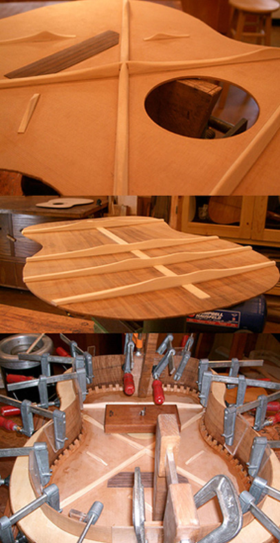

Here are a few pics that i took before closing it. As you can see it is a bit of an experiment ! Only a few very low bracings...Should be a loud one and hopefully it won't brake. The soundboard is from an old dead still standing western red cedar... I use hide glue to join the top and for the kerfling (hand made too).

How in the world did that rosette and the resulting hole for the rosette get cut? I have never understood how Mike Doolin and others do that spiral thing.

[QUOTE=John Kinnaird] How in the world did that rosette and the resulting hole for the rosette get cut? I have never understood how Mike Doolin and others do that spiral thing.
John[/QUOTE]
John,
I'm sure Thomas will tell us and I've probably got it wrong, but they look to be all circle cuts but with different diameters and centre points. The arc that bisects the rosette looks to be a very big curve with centre point somewhere outside the bass top bout.
Nicely executed Thomas - very original!!Dave White38656.4615162037
PostPosted: Mon Oct 31, 2005 6:04 am
Joined: Sat Oct 29, 2005 2:09 pm
Posts: 8
Thanks for the welcoming Doug :-)
Thanks for the all compliments and hopefully i ll get a good bridge design. I ve been drawing and drawing and cannot yet get something good. Ah ah ah :-)
Dave is 100 percent right this is exactly how i did it. Using an extension rig (the one from stew) on the dremel base. For the rosette and the big offset circle i just had to drill a diameter hole inside the rosette ( easy because this one gets cut out). And as Dave mentioned for the large arc i had to drill a diameter point on the bass top bout so i used a spare spruce square that i clamp on top of my soundboard and drill the hole in that last one. (really easy jig to make).
Cheers !
PostPosted: Mon Oct 31, 2005 6:14 am
I like it too, Thomas. Is the top flat or do you have some arch in it? Just thinking if it was arched whether the x braces, alone, are strong enough to hold the shape.
PostPosted: Mon Oct 31, 2005 6:21 am
Posts: 8
Hi Ron
Yes the top is arched (the bottom of the mold too...). The X-bracing are arched too. But it is true that with few bracing you loose a tiny bit for the arching.
But due to the fact that i ve hand carved in the soundboard i am not loosing much of the arc.
PostPosted: Mon Oct 31, 2005 6:30 am
Thomas, you're saying that the top is not bent to fit the bracing, it is actually scooped out concave to fit, kinda like an arch top guitar?
PostPosted: Mon Oct 31, 2005 6:40 am
Posts: 8
Yup but kind of half / half. My mold's bottom who is a cheap spruce top is carved in (like an archtop with a mini hand-plane).
The soundboard itself is sanded in a arched way (less than the mold).Finally the X-bracing using a jig has the same arching has the mold too.
And as you know for fitting all of them. Go-bars pushing the X-Bracing (while gluing them) to the soundboard who is sitting (during this process) on the bottom of my mold.
Now my back was bent to fit the back bracing :-)
